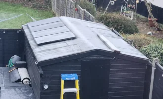

i run 400w renogy panels on the solar shed,
now powering a 105A lithium,
and its not enough to keep the battery charged, that just runs garden night time LED lighting.
