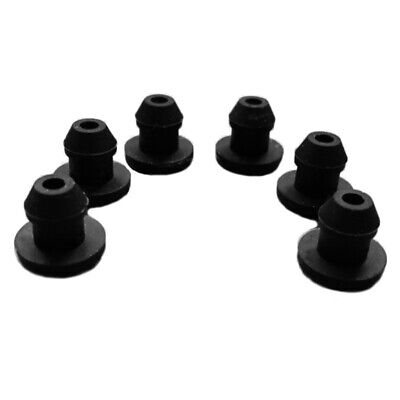

i am due to line and then replace the ply floor in my t6 during the conversion. I want to remove the lash /tie downs points but that will leave holes in the floor....
has anyone found a rubber bung that fills the hole where the bolt would be etc. There appears to some for the t4 but the message doesn’t say where they got them from
all help and suggestions welcomed
