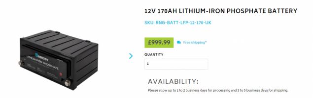

Renogy Release 170AH
12V 170AH LITHIUM-IRON PHOSPHATE BATTERY​
DESCRIPTION​
The Renogy 12V 170AH Lithium-Iron Phosphate Battery is perfect for deep-cycle applications including cabins, solar/wind energy systems, UPS battery backups, telecommunication systems, medical equipment, and more. Unlike gel or lead-acid batteries, the Renogy LFP battery is safer, lighter, and more powerful with a long service and shelf life to boot. Invest in this sealed, maintenance-free battery for your off-grid system today!
Note: Please be aware that if the batteries' Battery Management System (BMS) is activated and the battery voltage shows 0V, you must use a compatible Li charger to reactivate our Li batteries.
Note: Make sure to tightly screw the battery terminals in, having loose battery terminals will cause the terminals to build up heat resulting in damage to the battery.
If you have any questions regarding this product, please submit a case.

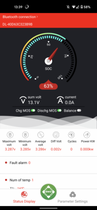

I decided to go with the Sterling 100ah (Clearance) - It cost £450 plus £10 next day deliver. I ordered at 10am on Monday and it arrived at 13:00 on Tuesdays.
The battery has all the standard required safety features that you'd expect from a Lifepo4 battery, low temperate disconnect and low voltage disconnect. It also comes packed in a fire retardant case and the prismatic cells are inside steel cells. It also has a Daly BMS with BT included. The BMS is fully customisable via the 'Smart BMS' application.
I've attached some pictures of the packaging and screenshots from the Smart BMS application. As you can see, cells are in balance, 0 cycles and sitting around 60% which is ideal storage capacity.
I'm absolutely thrilled with this battery! The reason I didn't go with the Renogy is because I couldn't contact them via phone and it took them two days to return my support ticket, which for my needs at the time wasn't good enough. I called Sterling 9am Monday, spoke to a chap asked lots of questions and was happy after a 10 minute phone call. Rock on!

Thanks for everyones advice.
