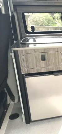

If you mean placing the heater externally in the OEM position and bringing the duct up into the seat base, it can be done as that was my plan. I spent along time researching and moving my electrics around to suit however when I fitted the heater I found it much easier to bring it up at the back of the seat base.Hi all. I’m planning out where to put my leisure battery, split charger etc but want to fit a night heater with the hot air vent coming up through the driver seat base. Will I fit everything under the seat or do I need to relocate the electrics to make way?
Not to hand but I’ll grab you a photo next time I’m in the van.I was wondering whether it was possible to bring it up behind the seat base. Thanks for the info. Do you have a picture handy?
That’s perfect. Thanks.Not the best as I’ve cropped a pic, but can’t be arsed going outside in the rain and cold.
