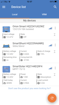

Panels working but saying ‘absorption’, shouldn’t then be in bulk as shunt reads battery at 74 %.
I have then checked BT of battery which has battery as 80+%?
Thoughts?
View attachment 260274View attachment 260275
Okay cool.You're right that you'd expect to be in bulk charge at that state of charge of the battery. However, given it's only running on solar, and the solar can currently only supply a tiny fraction of the rated bulk charge current then the distinction between the two is academic. The thing is, an MPPT in general doesn't actually 'know' what the current state of charge is, it can only infer it from the amount of current flowing at the set voltage. The current in this case is limited, not by the battery itself but by the ability of the panel to supply it, however my guess is that the MPPT itself has no way of distinguishing between these two situations and so it's assumed an absorption state. I don't think this is a problem as the battery is getting charged with what little power there is in any case.

and thoughts in the difference between the soc read on shunt and soc read direct from battery?
Thank you sir,Although all 3 Victron devices show in the app they are not talking to each other (unless you set that up - I think they all have VE bus) so the MPPT doesn't know that the Shunt thinks the battery is 74%
As @t0mb0 says it can only use the information it can measure, and with a voltage as seen by the MPPT of 13.43v which is pretty much 100% for a lithium based cell.
I remain puzzled by the difference in voltages in your system, some variance is to be expected but Victron is good kit so a difference of 13.43 Vs 13.34 when both devices should be pretty directly and cleanly connected to the same battery is odd.
