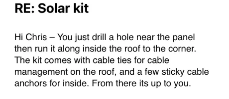

Is solar wire in yours a single wire that enters van and then splits +/-? I’ve done shed solar before but that was all MC4 connectors
Yes - single black cable from the panel that then splits in two.

You may not need the bypass diode. It could be embedded in the panel. Ask the seller for confirmation.
With regards the crimp you’re literally just looking at one of these. Crimp your solar output positive into the terminal, connect it to the CBE fuse panel where I indicated and plug the other wire that you removed back in on the spare terminal.
@Chris1983
The question to ask is whether the panels have any embedded bypass diodes for if the panels are partially shaded or if they are required.
I think after that, a bit of poking about around your van and you are sorted.
Confirmed panels have shading diode built in! Will get poking (oooo errrr).
