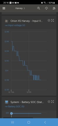

My starter battery drops well as soon as the engine is turned off. 12.5 + on switch off, voltage plot courtesy of Cerbo from midnight last night until now.
Ablemail will kick in when SB voltage goes below 12.3v as long as LB is over 13v. Default setting 4.
I have a 12 month old Bosch 95Ah starter battery. Engine switched off at 5pm yesterday. 0.1v seems like a normal SB drop to me.

Plot shows midnight last night to 8pm tonight. Van not driven today.

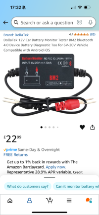

How are you measuring these and when? As mentioned the battery drops rapidly in the first hour after shutting the vehicle down. It will also drop when you unlock the van as all the systems fire up. Having something like a BM2 Bluetooth voltage monitor is great because you can see a plot of the voltage and check it without having to unlock the van and open the bonnet.

For the BM2, am I looking at the 22 quid one from Amazon or is there a certain brand you would recommend?
Just make sure it’s one that can datalog.
On eBay there are some cheapies that appear identical but will only show data for the time while you’re connected to Bluetooth.

Letting it rest for a couple of hours is good, but unlocking and opening the door starts up lots of modules and puts a load on the battery, thereby dropping the voltage. The voltage will recover when everything shuts back down again and the battery settles, minus a tiny amount that was used to run everything. Something like a BM2 will allow you to remotely measure the voltage without firing anything up on the van. I have this one and it’s been great:
