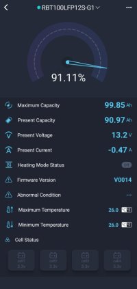

I also have the Renogy battery display and that shows no obvious issues, good voltage, full charged etc.

Took the seat out and plugged the Bluetooth monitor directly into the battery and everything looks good with the battery.
