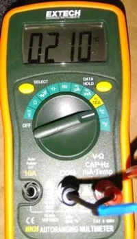

Test setup to emulate front heater fresh air blower:
The protocol:
Note: This is not the temperature at thermal fuse - just on resistor surface having a sensor glued there and covered by a foam patch. Would be another challenge to pick it up on/in the fuse. Just wanted to clarify to myself what's going on in the neighbourhood.
Actual wiring diagram used in the test- same principle and pinouts as for front blower (shown earlier in the thread).
However, under slightly different conditions... pushing up battery voltage, intake air temperature... reaching already 210 °C :speechless:
Excellent work there @mmi:thumbsup::thumbsup::thumbsup:
Interesting the resistor surface temperature on speed 1 is 180 deg. As expected - maximum voltage drop, maximum dissipation. It would not take much to increase the dissipation; i.e. Increased input voltage or higher current draw by a cold motor with stiffer bearings/bushes, and then you could get to 192 deg fuse level. The fan motor could be running slower so less air flow too over the resister pack and fuse.
