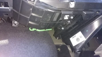

which looks very simple (and as I have found on other VW vehicles), however, my MY2016 Highline has the Resistor Pack facing the bulkhead! Please see the photo below (green component):
Is there more than one version and different associated instructions for this procedure? Looks to me that more dismantling would be required to get at the bolts and enough room to withdraw the resistor pack?
Anyone physically done this yet? Hoping to get mine done under warranty but I was intrigued at how you would get at it when I was underneath the glove box for another job.

@Dellmassive Thanks for posting the instructions which looks very simple (and as I have found on other VW vehicles), however, my MY2016 Highline has the Resistor Pack facing the bulkhead! Please see the photo below (green component):

just one version from what i can see. . . . . .
you might have to use a inspection mirror to see the fixings . . . . . basically do it by feel.
use a small 1/4inch ratchet to squeeze in there, not sure of size exactly . . .. . maybe 6mm 0r 8mm ish?
Edit: Credit @T66RUB - You need a 5.5 mm or the equivalent in imperial
@T66RUB has done his

Yes did mine myself, admittedly it’s in a awkward position but I managed. Mine was green but tried the cheap T5 version (black one) and everything works ok up to yet. 65 plate T30 180highline. You need a 5.5 mm or the equivalent in imperial? Remove plug first and refit last. If it’s through warranty fine but mine was 4 weeks out and VW weren’t interested.

Thanks, I’m surmising it’s a 5.5mm because 5 mm was too small and 6mm too big, ended up using a small mover which took a while because you can’t get a ratchet in.
