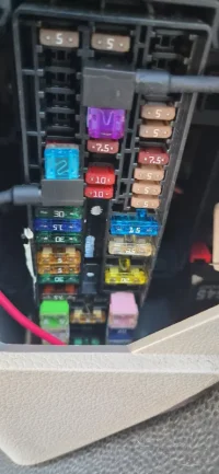

Hi All.
My aircon stopped working today - it has been working fine :(
The fan speed controls are fine, and increase through all 0-1-2-3-4 settings, but when I press the A/C button nothing happens - no A/C 'on' light and no cold air.
I'm wondering if its a fuse but have no idea which one is the A/C fuse. My Owners Manual is useless and I've searched all over the web for the fuse box the same as mine, but they all seem slightly different. My fuse box type is shown in the attached pic below.
Does anyone know which fuse is for the A/C?
Some of the bottom fuses look really tricky to remove and I don't want to try until I know for sure which is the correct one.
Cheers, for any advice.

Is it etched on the inside of the cover as to which fuse covers what system?
It could be a multitude of things. Fuse, compressor, gas leak, pressure switch...
I presume you haven't scanned the van for fault codes yet?
