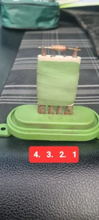

Just changing the resistor pack/thermal fuse and not looking into why it blew it in the first place is a recipe for a repeat burnout.
Have you taken the motor apart and cleaned/lubricated the bearings to ensure they are not the cause of the increased current draw?

Just avoid set point 1, I’ve had 3 failures, every time in set point 1.
There's your problem.
There's the solution.
Thank you for this. 20 min job even for me.

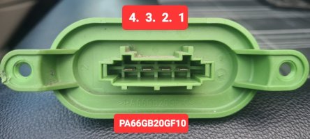

Same issue...replaced the resistor pack with one from Travelin Lite on my 2017 204 T6 and all good!!

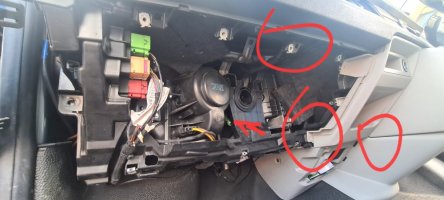

View attachment 37807 Gambled on this from eBay works fine, easy DIY fix, remove black plastic cover under glove box. Get your head under. Unplug ,remove two screws, replace. View attachment 37807
I bought this part but found removing old part far more difficult than this suggests … it’s wedged up at the back .. another black plastic section that is bolted on seems to in the way….
edit …..ok I see it is a matter of fiddling around in a tiny area to get at the part .. but mine is so wedged up at the back you can’t even see the plug or wires .. ill give it another try tomorrow ..
but it seems so tight in my van I can’t see removing it or fitting the new one will be without major hassles …

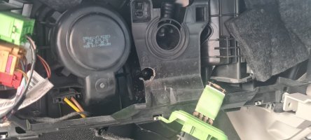

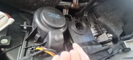

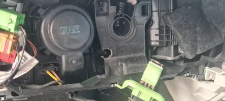

Has anyone managed to remove this on a kombi with carpet ? I can't get the plug out, but have manged to get both screws out which I thought might buy me some extra wiggle room but I'm unsure as to how the resistor will actually manage to be removed ever with the plug disconnected. I'm losing my fingertips here!
I don't have a kombi but everything about the blower including the resistor is an absolute b*****d to get out! My advice is find someone with smaller hands ;)
I remember it seems impossible but there is a certain angle and it comes out easy … sorry it’s been a while since I did mine .. it can be done though I struggled too
Once again, the forum came to my rescue. Same problem as many of you have reported - blowers works on 4, but not 1,2 or 3. Ordered the part from Travelin-lite and twenty minutes later, I got all the blowers working again, the trickiest part was actually detaching the clip.
