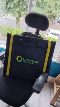

So after all that, just turned up out the blue a day earlier than the tracking suggested!
Better late than never...

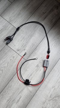

I'd bought one of these cables to connect to the battery charger.

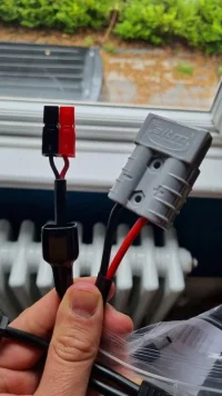

The panel comes with an adapter for Anderson connectors... Every day's a school day, I've just learnt that Anderson connectors come in different sizes!
So looks like I need to make up a new cable, would you guys suggest I cut the end off the one supplied with the panel and fit a bigger plug or vice versa, cut the one at the charger end and fit a smaller plug?
The one that came with the panel (smaller) seems a bit flimsy and the cable is much thinner...the Amazon one is rated to 50A...which may well be overkill.
Any suggestions on which is the best way to go with it??

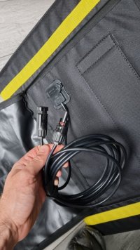

So the panel comes like this, a length of cable with MC4 connections...

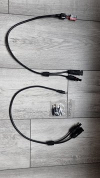

And then mine has a few different short lengths/adapters...
So the MC4 to Anderson cable should do you.

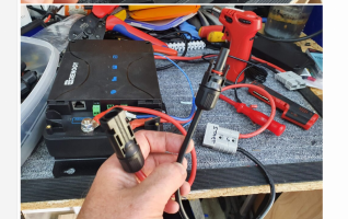

I've just got to work out how to get from this to this...

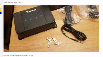

Thanks @Dellmassive, I'm using the 50A Renogy DC to DC with built in MPPT hence needing to get from MC4 to M8 eyelets somehow... The solar input goes straight onto M8 lugs... So I need some sort of fused quick disconnect solution that's close to the Renogy box under the seat.
That 50A tail lead from Amazon would be perfect but it's a different size connector and cable thickness to the Powerpole adapter/cable that came with the panel...

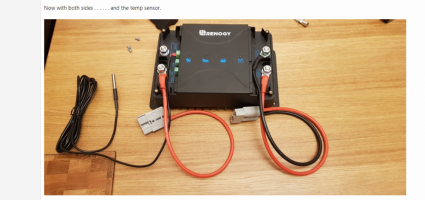

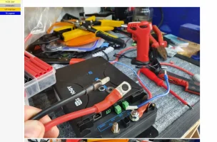

this is what i done with my Renogy DC50,
i just made up my own cables. . . with luggs, cable, mc4, heat shrink etc etc.
then i added the MC4 solar conection>>>
gotcha . . .
Thanks Dell, thought it was going to be a case of making up a cable. Just trying to work out the most economical way with the bit sand pieces i've got.

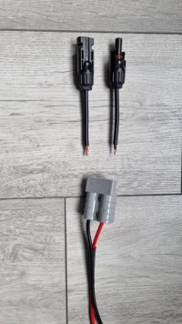

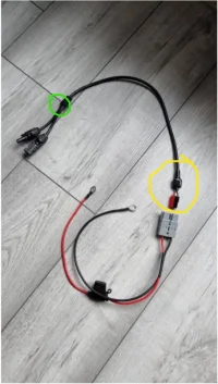

So I'm thinking if I keep the Amazon cable (this one)
as it already has an inline fuse and battery lugs so saves me a couple of jobs...
So i'm thinking i would cut at the green circle where its still 2 wires (rather than the thinner cable at the yellow point - assuming the cables cores are actually different) and then put a bigger Anderson connector on there. It's a portable panel so want a quick-disconnect solution, that will be my disconnect point so i'm not having to try and take apart MC4 connectors which are trickier.
That would work right? No issue with putting an Anderson connector on PV wire??
So assuming that cable is 4mm PV wire, I just need to get the right Anderson block and terminal ends...
Just got one of these...so hoping i can splice that onto the end of the PV cable.
Mc4 conectors are single use... once crimped and fitted... thats it.
So cut them off and fit new.
i would keep theis cable.
but cut off the Anderson connector.
that would then be bolted on to the Renogy DC50 MPPT as the solar input. . . . . .
i would then crimp new MC4 connectors on the bare cable ends . .
that will give you the quick - disconnect under the seat . . . or where ever.
next id use a MC4 to MC4 extension cable to get out to the location of the panel. - out in the sun away from the van.
then plug that into your solar panel . .
