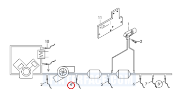

I will try This in the weekend, but as you probably could see from the log file i sent the exhaust temp sensor 2 is not showing the right values, so i think i need a new one anyway, is there any etk catalouges Where i can find the part Number?
Reactions: mmi
Ahh.. now I see -40C :eek:. The sensor might be critical for the DPF regeneration...
I have used site
Select Free Services > CarProg2 >
Navigate to
Thanks for all the help.
I changed the egt sensor 2, and needed to do a forced regen.
