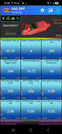

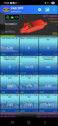

Hi, so these are timber cold and hot idling screen shots!Just the same screenshot as before/below
Quite high pressure across the cold DPF. For a healthy one should be well below 10 hPa.timber cold
the same also for hot DPF - too much resistance in the DPFhot idling

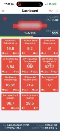

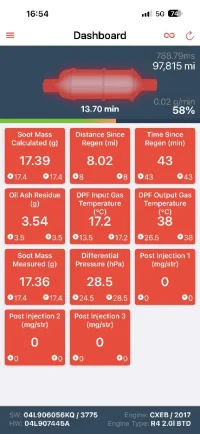

I see there is quite a difference and running hot, mine was revving high at nearly 1000.Do in need a DPF clean don’t think or a diagnostic run? Weird thing is, no light. Also, it regens at 24g which seems low. What would your recomendation be. Hopefully it’s not burning oil and getting the probs so many of these seem to have had.Quite high pressure across the cold DPF. For a healthy one should be well below 10 hPa.
For comparison please check below (Note: hPa=mbar)
Based on your screenshot the engine was doing it's regen - red DPF + timer.mine was revving high at nearly 1000
The DPF has obviously reached the point where no amount of regenning can clear it.Do in need a DPF clean don’t think or a diagnostic run?

As the pressure depends on air flow, higher revs make the numbers look worse.
