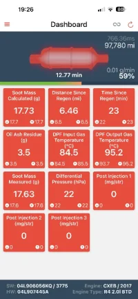

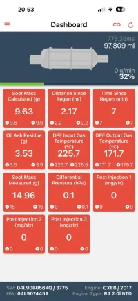

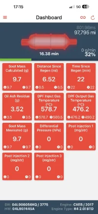

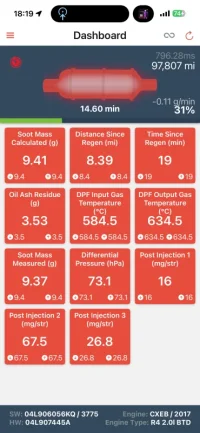

I have an OBD reader (bluetooth) and an app, my regens seem to be happening VERY regularly. will check what soot level they start at, an update might be a good option. Has anyone got to the bottom of why Regens might happen more often than not an whether they will eventuallly do damage? I have a T6 204PS 2.0 tdi. Thanks
How often?
Post some screenshots
My regen starts about every 350km.
This the graph on page 65 taught me a lot. When I look at my soot calc value it starts to regen around 18grams just like what the graph says. Although I have never seen that dash light buring.
