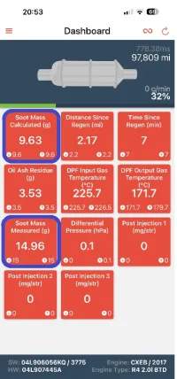

Low mileage used DPF fitted after an off van clean and new pressure sensor fitted for good measure.
Cold idle DPF pressure is now 5 hpa and warm idle is 9 hpa.
Will take for a decent drive over next few days to see when the regen kicks in. I think the van needs a regen to recalibrate the DPF app.
@mmi sorry to message again,

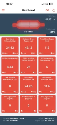

I was checking the van today and noticed the oil ash residue hadn’t been reset by the garage so I reset it back to zero and took the van out for a drive.
Drove 35 miles on mixture of roads.
What seems strange is the soot mass measured still seemed to rise quick, after the drive it was at 11.24g, where the soot calculated was at 2.28g.
The differential pressure seems to have risen to 12.8hpa at warm at idle vs 9.8hpa yesterday.
Based on DPF app, I believe it would now regen about every 3hrs and 115miles so it’s definitely an improvement. But I wondered the DPF or pressure sensor needed resetting or if the van will adapt after regen or after it’s been driven for few 100 miles.

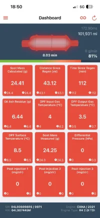

I carried out differential pressure sensor adaption and then went for a drive, at first it gave off some strange reading as the soot measured shot up but after 10 miles the soot measured started to drop. After a further 15 miles the van started to regen even though the soot measured or calculated were not near the 30g limit so this must have been triggered by the ECU as part of the reset.
Following the regen the DPF figures were much more in line with what I would expect on a normal functioning DPF.
DPF 26% full
Soot calculated 6.90g
Soot measured 0.7g
Differential pressure at warm idle 7.5hpa
If this continues in this pattern it should now show the soot calculated triggering the regen rather than the soot measured as it did before when it was blocked.
