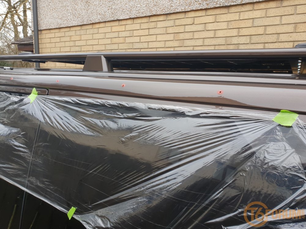

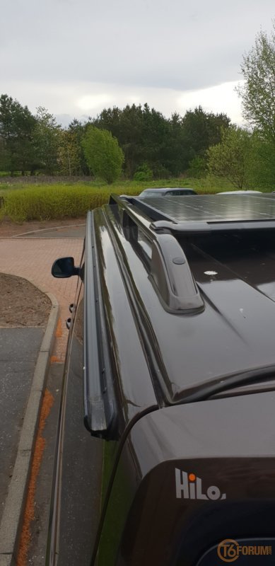

Aye ;) I'm impressed, looks neat and works well with Hilo. Fitting instructions are spot on, you first fit with self drilling screws then replace when fixing in to place. I was a bit cautions and used smaller self tappers to offer up so I could have another go if I made a mess first time round. I also took the time to prime the bare metal and give it a coat of paint. Give them a call as I got a discount for ordering direct ;)

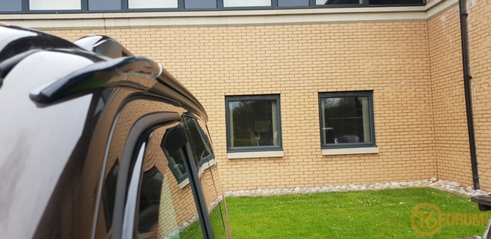

https://www.t6forum.com/media/ar1.1653/full
https://www.t6forum.com/media/ar2.1654/full
https://www.t6forum.com/media/ar3.1655/full
