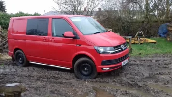

Hi. after getting my 2019 swb 4 motion stuck bogged down on a wet piece of grass
do you know if the electronic diff lock can be retro fitted ? Not sure if that would have helped but worth an ask. VW never mentioned it was an option when I bought it till after the event.
This has come up before, I got my 4-Mo and the rep never told me it was a £500 option which was annoying to say the least.

dealer told me it’s now £600 cost option 1st bit of tricky work and it let me down. On the bright side it drove fine on the wet grass till it stopped and sunk
I agree, I don't think you can retro - fit a diff lock, at least not without major work and expense.

to be fair the ground has had 4 months of solid rain so Prob wasn’t my finest hr driving on it.
Safe to say customer not impressed and all the other trades pissing themselves laughing at me. was thinking on the diff if it had been fitted it might have bit in better just to get moving again. As it was happy driving on the grass. Was hoping it was already wired and we could slip in the switch and get the ecu re programmed.
Trouble with driving on grass is it all looks the same, but what's under it can be the problem, I've a feeling that the soil under that grass wasn't capable of holding the weight up and probably only mud tyres would have got you out. And none of us want the on road characteristics of full on mud tyres.

If you have the DSG box you could to try use this +/- selector ...drop in to second ( or low gear)and try to avoid too many rev’s....it’s a lesson I learnt not too long ago.
But if your sunk. Tray car mats ( they can be cleaned later) :thumbsup:
Mines a manual but yes I tried using different gears and rocking. Almost had it but the guys helping push were bit pathetic and would rather watch in the dry. Yup jet washing this inside today.
I’ve done bit more research and it’s an expensive retro fit of whole new rear diff with some mechanical bits in it. and wiring plus ecu reprogram. £600 from factory option doesn’t sound to bad now. Just wished they had mentioned it. Thanks for all your replies
