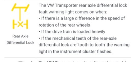

Any of you good people can help me out with this warning, keeps flashing on the dashboard, Scanned for errors and have none, no fuses blown.
Drives as usual, I have 2017, 204ps, DSG 4motion with no diff lock button.

Have you activated it recently? It will flash whilst transitioning from locked to unlocked.
You may need to make sure it's disabled and then move backwards and forwards whilst turning the wheel to weave the car and remove tension from the locking pin.

Just tried moving side to side backwards and forwards no luck . It's just a normal 4motion with no difflock button to activate it. I've had the van since new and this is the first time the light been on. Cheers buddy
OK so not the diff lock then:confused: if its the haldex warning without recording error codes, that's new.
Are the tyre pressures the same on both sides? It will complain if there is an excess difference in the wheel speed.
The tyre pressures was the first thing I'd done to make sure they're all the same. Do you think the haldex device might need servicing then? Do you reckon it would do any damage if I keep driving it until I get it sorted?. Can't do anything until next week due to work . Cheers loz
