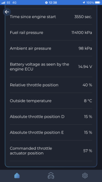

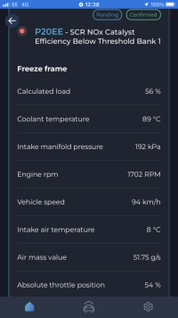

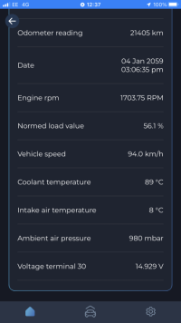

Hi all, could I ask for some advice please from those here that understand these things? Took the van out for a spin this morning, its been sat in my yard since last Sunday. After about an hour or so of mostly dual carriage way driving @60-65mph, the orange engine management light came on. Luckily I had bought a Carista a few weeks ago so pulled over, switched off, got out and locked up. Left it locked for a minute or two, unlocked, got in and fired up again, orange engine light was still on. Turned off and fitted Carista then turned ignition on as per Carista instructions to diagnose.
Carista showed 2 faults which I have screen shot and posted below. I cleared the faults and turned ignition off, exiting and locking the van again for a couple of minutes before entering and starting engine again. The fault stayed cleared. Drove the van for 30 minutes @ 70mph in 5th gear (dual carriage way) keeping the revs at just below 2500rpm. Engine light stayed off. Im now back home and no engine light on.
I would be very grateful if anyone here translate into plain English what the fault shows, what it means and is it a serious issue?
The first two pics are from the "Engine fault" and the second two are from the "OBD2 Fault"

I have the same faults and only come on after a long run. P20EE is generic and I have P204F which links with your other codes. All SCR related. Mine has been in 4 times for a fix so far without success. Going in again tomorrow and costing me £500 for them to look at it even though under warranty and no guarantee they will diagnose

Thanks Hilly. Could I ask, what is SCR when you say SCR related?
I’ve also just noticed the date and time for when the fault was logged is out and that the mileage showing is out too!! Weird!

These faults all seem to follow the same pattern, only crops up on a long run, too much of a coincidence and in my view the way they test the SCR system under the VW TPI is not specific enough as it is a static test with the vehicle not running at 60 - 70 for hour or so
I had this fault 5 times or so when van was new , cured with software update . Worth checking the van is running most up to date software .
