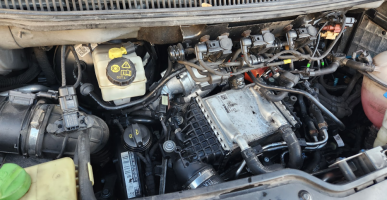

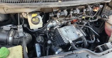

the engine bay from up topo looks basicaly the same, as the Long Block engine has all of your bolt on ancilleries swapped from the old engine to the new.
so all this is from before.

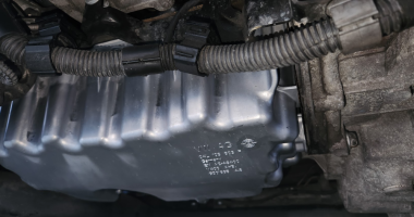

but from underneith it looks a lot shineyer . . .

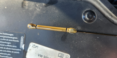

checking the oil - its so clean you can even see the level. . .

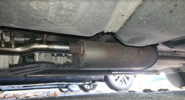

further back we see the berand new DPF and CAT . . .
thats all connected to the rest of the system - ie just the back box left.
its tricky to see the engine block as there is so much stuff wrapped around it. . .

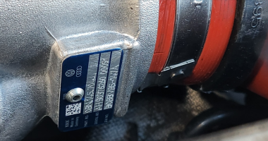

but from this pic, you can see the top of the shiney new Bi-Turbo.
zooming in . . .

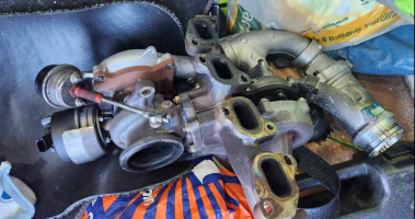

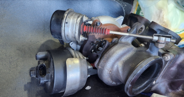

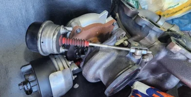

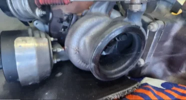

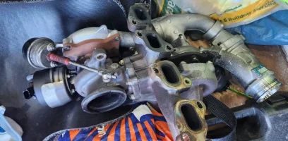

and sitting in the back of the van is the old turbo. . . its a beast !!
80K on this one and it looks perfect. - no wobble in the spindle or oil leaks.
ill be selling this one as a working unit ready for a direct replacment.

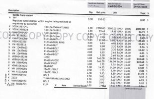

so what did the new turbo cost in the end?
well - with 10% parts discound and £0 Labour,
we were at £2582.97 + vat
that gets us to a cool £3099.56 !!!
ouch.

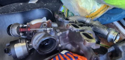

heres the break down,
the main Exhaust manifold + Turbo, with all the required associated parts.
for the CXEB 204ps Bi-Turbo
heres a closer look at the old one,
1732297743668.webp1732297757382.webp1732297768223.webp1732297783318.webp1732297799601.webp
Just wondering why the new turbo? Belt and braces?
yes kind of,
research on here shows that most people on here show that the 204ps BiTurbo unit needs attention or replacing between 120K miles and 180K miles from new.
so by replaceing mine now ( at 80k miles) . . . im gaurenteed to be happy for the next 120-180k miles in regards to the turbo.
my thinking was that while the engine i out, its a £0 labour for the swap.
versus a possible £1k labour charge a bit later down the line.

lets have a look at stuff we can see. . .
zooming in . . .

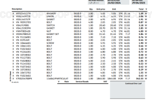

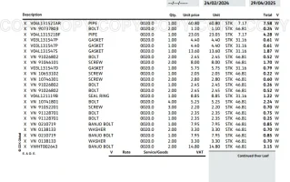

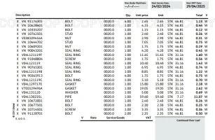

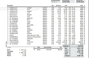

We finally got some paperwork from the dealers for the CXEB engine swap. . .
its 10 pages long !!!
the BiTurbo is on separate paperwork, - as i paid for that.
the DMF is on separate paperwork as that was under 24mnth parts warranty.
looking like:
£7871 Base Engine
£1845 DPF
£1440 CAT
£295 Oxygen sensor
plus all the other bits,
plus labour
plus VAT
lets take a look. . . . . .
£98 an hour + vat, and thats warranty rate, wonder what their normal hourly rate is for retail customers !

FYI - the service manager did say the paperwork was for reference only.... It's my proof that the parts/ work has been done.... But the actual prices and rates are between the dealership and the WV All-in insurance. So none of my concern.
But it makes interesting reading.
The amount of additional new nuts and bolts etc that are required to be fitted by VW are astonishing..... And I've watched serval cxeb engine rebuild videos where the original bits were refitted..... For example brand new engine mount bolts.(Nothing wrong with the previous ones I'd assume) but the service manager said VW were very specific.... And if even one bolt was not replaced as per the service manual then there claim would be refused....at any point in the future. As in a tech could review that case 6mnths down the line and decide a bracket wasn't replaced at the time and then reflect the whole job and take the warranty money back from the dealership... Which is why the garage was so finiky.
