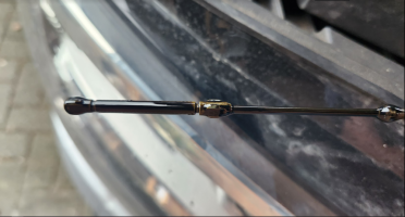

Update:

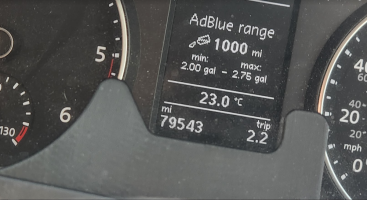

oil usage test is under way.

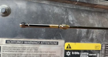

1st oil disp test: start of test, 79543miles, - oil level at the top of the dipstick.
second oil dip check. . . 79736miles - 200miles into the test.
(looks like we have already dropped 1/4 of the dipstick)
3rd test comming soon. . . . we almost at 400mile mark.
Edit third dip. 320 mile
TBC . . . .
Following this with interest, when they did mine the oil level was above the full mark. You look like you may scrape past the 620 with your current readings

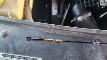

i think ill smash it. . . its 0.5L, so half the dipstick for the 620miles (1000km) for a fail.
im doing about 100 miles per day atm. . so they are clocking up quick.

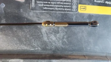

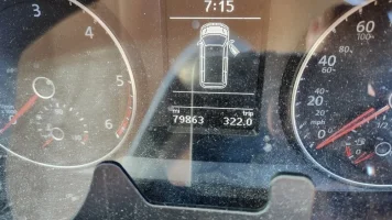

Third dip test.. 320 miles in
About a third down already.

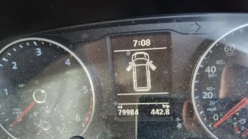

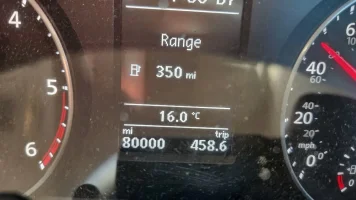

4th dip test .. 442 miles in.
Looks like half way, ie 0.5l already. So that's a fail IMHO.

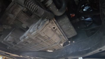

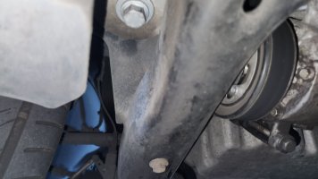

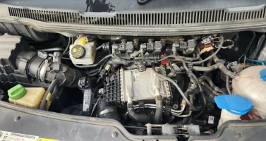

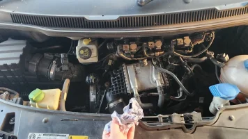

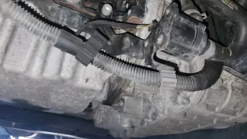

And just for the record...
The engine is bone dry..
20240830_070833.webp20240830_070825.webp20240830_070809.webp20240830_070755.webp20240830_070759.webp20240830_070819.webp20240830_070721.webp
  • Sad

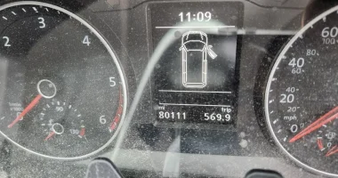

5th dip test . . . 80111miles - 570miles into the test.

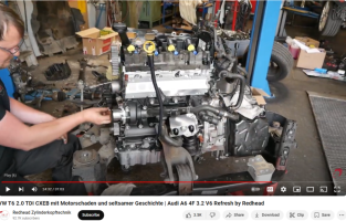

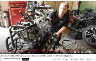

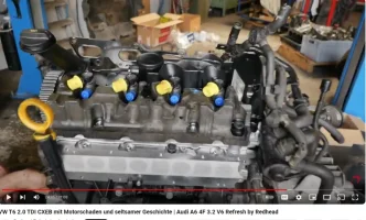

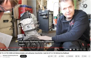

redhead youtube videos they are of the opinion that the CXEB/CXEC
I was so hoping for this in your T6 when I first glanced at the screenshot!!!

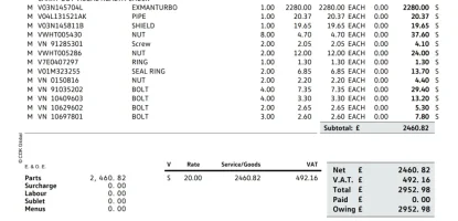

as for the Turbo, I've had some prices . . . and its damn expensive. - £3k expensive, and that just the parts.
I called TPS for a quote, . . .
this is the Bi-Turbo, plus required pipe, plate, seal and bolts (due to the revised part) (retail prices)
well they call it "Exhaust Manifold with turbo charger" - so assuming its just that - the whole assembly.
interestingly they also said that its available in its split form, so upper high pressure turbine and lower low pressure turbine.
but ours called for the whole assembly.
so £2857 for those few parts
and this is the list from the VW garage. which shows the Turbo and bits above. . . plus other bits and bobs the VW OEM book calls for to be replaced,
and that totals a cool £2953 of your Great British Pounds. (retail prices)

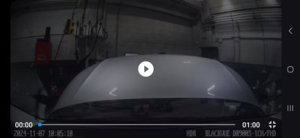

Update.....
Looks like the van has come back to life.
The dashcam, wifi, tracker, Victron and leisure battery have sprang into life.
So that must mean the battery is back in with a charger.
It's in the garage.... So assuming we are having engine work done?.
And then two days later, it's out on a drive and now in a carpark.
Still haven't heard from the garage, so hoping for a call on Monday?
