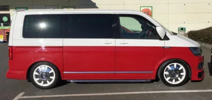

Thats mine with standard Exec springs, and slightly larger tyres (about 11mm bigger all round) 235/55/18, oh and wheel spacers
I like the DCC but swapped mine out for Bilstein B14’s and H&R ARB’s just for aesthetic reasons. I also kept the full DCC parts in case I fancy swapping back sometime. Bognor did mine.
Top pic, before with DCC
After with Bilsteins

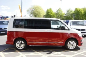

Yours is the only T6 "Limited edition GEN6 " to have DCC on stock height suspension (not 20mm lower on dynamic suspension suspension" I Think.
My Gen Six has DCC and I am not sure that it’s 20mm lower (sorry for the snow foam, let’s the best side shot I have)....
Getting it lowered is next on my list...

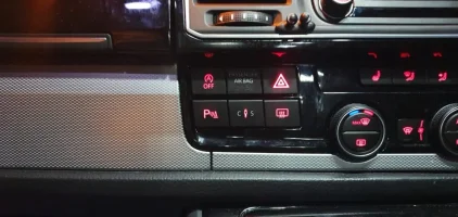

Hello everyone, I have a VW T5 GP c 087 BCM, after installing the T6 full led headlights I decided to make a controller to control the standard DCC suspension. I installed the DCC kit six months ago and did a counter-controller and tested it. It was necessary to remove the CAN bus, do not use sensors and binding to the car, so that you do not need to change or change something in the car and installation is possible on any car (T5 c 2003) .I managed to make a controller to control and get 3 suspension modes . I used any regular button with any icon (no matter, you can use the regular one from T6). For installation do not need the regular wiring only need the shock absorber and my controller, which simply plugs in to the power supply. There is a display of 0.96 inches for displaying the mode and if there are errors indicating the number of the shock absorber, I can draw a diagram for connecting the controller if it is interesting. Modes comfort as if the amortizers are disabled, sport as if the amortizers are rigidly fixed, there are no rolls. Modes can be "shifted" but this I can pass the program.

here is schematically, wiring conducted on the existing highways on the bottom of the car, to the passenger seat, entered 4 highways under the driver's seat, there is a small interchange for power and protection fuses, the unit itself is in the glove compartment for now, the screen is temporarily built into one of the torpedo plugs, the button used ESP OFF, but turned it over to distinguish it from the original function. The controller controls the DCC shock absorbers using 3 pre-configured modes , but I can adjust the modes depending on my wishes or the driver 's wishes.
