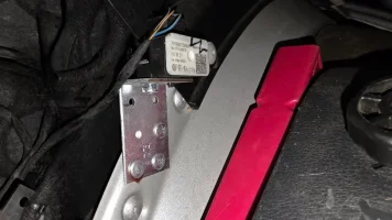

Is this the right place for the rear acceleration sensor? I know I ask after the fact, but I wanted to make sure.
Yes, this correct location.
Below is mine, I only realised now that I forgot to post this photo. Thanks for your reminder.
By the way, did you get learning procedure completed?
Not yet. For now, I've put on rear shock absorbers, position sensors (these 2 in front are not yet connected), all 3 acceleration sensors. I'm waiting for a "moment" of free time to replace the shock absorbers on the front. I upgraded the DCC module to version 071, successfully. The update lasted 27 minutes, and finally the required adaptation (channel 30: save 1).

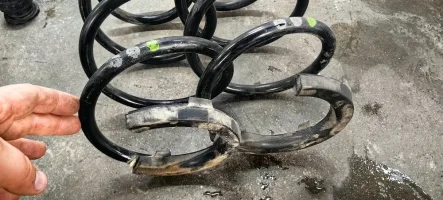

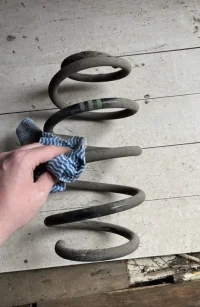

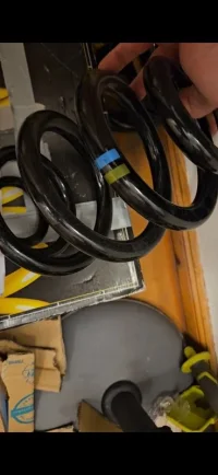

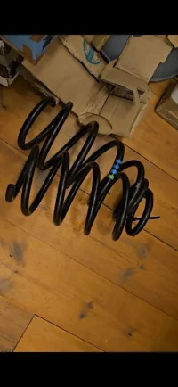

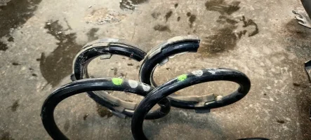

One more important point - the upgrade to dcc is no good if the springs are also not replaced. There are specific progressive 20mm "lower" springs which are mounted together with the dcc. It is possible to get this done as well. At least in Europe getting the right color marker springs is about 100 eur incl shipping for a used kit in excellent condition.
The springs must correspond to your weight rating which you can lookup on the vin sticker under the bonnet or on your options layout (usually I find out this info by checking the vin number).
