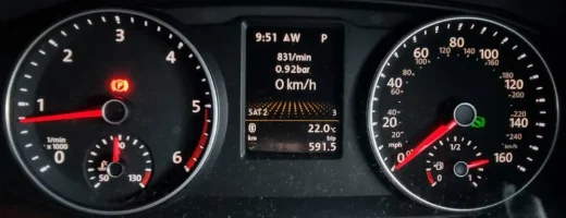

DAKU'S VAG CONTROLLER for PQ25

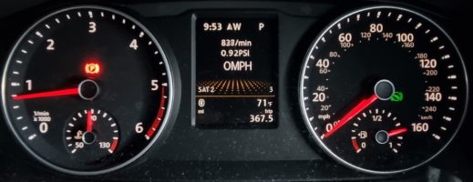

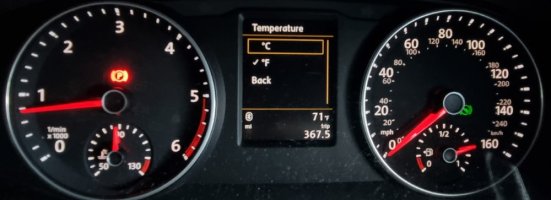

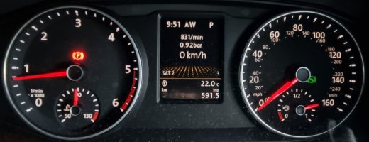

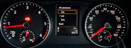

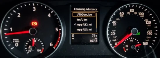

Another improvement introduced.
Displayed units follow adjustment in the MFD settings menu.
I guess photos are self explanatory.
20230619_095159.webp20230619_095436.webp20230619_095447.webp20230619_095457.webp20230619_095316.webp

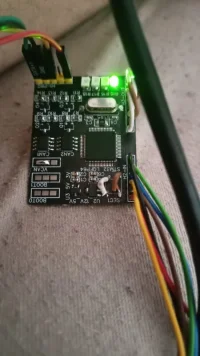

Here's another take to solve the problem. Similar display but different solution.
Connection under the steering wheel to CAN bus only and positive/negative wires. Dash intervention wasn't required so totally non-invasive.
To move onto the next session - OK is pressed on the steering wheel. It was designed by a friend as a quick and dirty solution. Firmware updates are flashed into the control box using USB.
Don't want to spoil this thread.

I am planning to do a video on it on my YouTube channel, but there won't be much in addition to what I already showed on the screens.
There might be a possibility for me to supply these (use pm pls).
