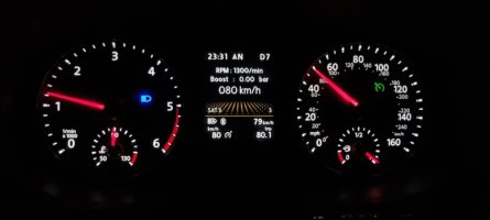

This is demonstration of just one (of many) amazing functions which come with @Daku's controller connected to Instrument Cluster CAN-BUS.
Basically when a mobile phone is connected to the vehicle OEM hands free kit the BLUETOOTH ICON is being constantly displayed at the bottom of IC display.
This icon is visible at all times and regardless of which menu is being currently viewed.
Small but very cool OEM alike add-on :cool:.

ENGINE DATA

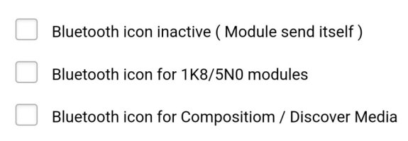

@Daku's design/configuration allows to transmit BLUETOOTH ICON to IC from an OEM wireless kits which don't do that by default ( quo vadis VW o_O? )
I have no knowledge of your aftermarket head unit so can't confirm.
But for your convenience I can show you possible configuration for the BT icon, see below.
