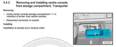

Sorry for reopening an old topic but is there someone who could explain to me how to remove the grey/beige block on this picture ? (Not the fusebox panel but the one where the 12v cigar socket is)

With brute force!
See Cigarette Lighter socket removal? for tips
and 12v dash din for how it looks like once removed (so you can see where the clips are)

How do you get the part with the 12v out?
Like the whole thing from the dash…
