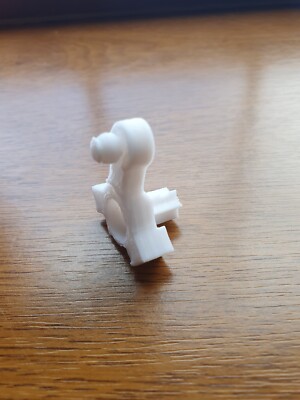

Blimey I can’t believe they have repair kits now, hopefully the repair kit has a stronger replacement.

I had to buy the heater Matrix to get the part which was used as a pattern to 3D print a stronger modified version.

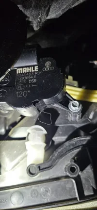

I have removed the black cover below the drivervside dash and taken these two pics.20240203_134242.webp20240203_134018.webp

Thanks. Garage haven't taken dash out yet but are adamant my 2018 T6 doesn't have this plastic part. I did find this in the driver footwell and am wondering if it could have held a cable that is now loose? Looking like a dashboard out job to rectify.
Funny you should say that because I cannot find it either ( 2018 T6).I posted the pics above of what I see looking up on driver side.

Do you know what the lever/ball/ pulley thing does in your pics? Well it move manually? How easy was it to get to? Willing to have a go if it was easy.
Updated after call.to garage. Mine doesn't have a cable as its full on climate control not just a heater. Who knew?! Still 2 possibilities. 1. Link between motor and arm (only part of dash needed out for this)....this still sounds like the white plastic but to me 2. Flaps not working in heater box, huge job as new heater box and full dash out to replace.
