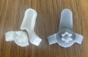

Haven't been able to get a response.Finally got my heating controls fixed!
The issue was the white arm in the picture. One of the ends had snapped off.
Now replaced with a 3D printed one (black)View attachment 233109
I have spares so feel free to message me or email me ([email protected]) should anyone be in the same situation and need one!

So bit of journey, I've uploaded a 3D model for those wanting a DIY approach to fixing this problem.Haven't been able to get a response.
