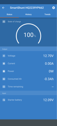

hi chris . the idea is to extend the life of the starter battery at the sacrifice of the leisure battery which i can get out of the van and charge in the house , the leisure battery seems to get to about 13.1v after a charge so should/hopefully extend the life of the starter . dont have any solar on van but hope this will keep vane above the dreaded 12v mark for a bit longer periods . i do have a victron shunt fitted and have just set it up to read starter voltage over the blue tooth so i dont have to open van to check voltage of the starter or leisure battery just have to stand next to van . just to add a point when i check the starter this morning got 12.38v on opening a door but not switching the ignition on starter battery dropped to 12.05v and after exiting and leaving it for a few minuets for the clicking and moaning and groaning from under the bonnet to stop it went back to 12.38v , seem like there is something very power hungry going on when you just open a door . best thing i bought was the victron shunt , or was it ? . ( spent loads after this )Hi @lummy is your plan just to use the Trickle Charger.... No other solar or mains connections to it etc... if so sounds great and what I am gonna do as well. Ran it past garage which can hopefully sort for me...
This is normal. When you open a door/unlock the van, the van wakes up & powers up the electrical system in anticipation of a start. The fuel pump starts, the ECU powers up, the head unit powers up & the interior lights come on, to name a few. This is why folks get a flat battery when camping & not running the van.…. just to add a point when i check the starter this morning got 12.38v on opening a door but not switching the ignition on starter battery dropped to 12.05v and after exiting and leaving it for a few minuets for the clicking and moaning and groaning from under the bonnet to stop it went back to 12.38v , seem like there is something very power hungry going on when you just open a door .
