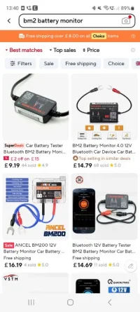

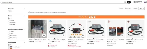

Yeh all same.
Legrand manufacturer.
Those are just different resellers.
