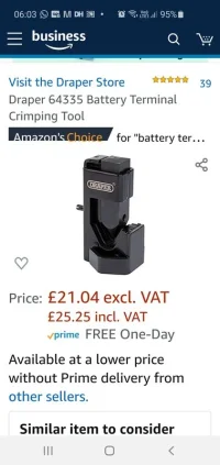

I've used one of these for years for various jobs. Boats/trailers/winches etc. I use a large bench mounted vice to apply the force, not a hammer. Never failed, cheap, cheerful, reliable. I never solder stranded cable crimped joints as it's bad practise. I use adhesive lined heatshrink between the lug & the cable insulation.
