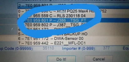

Apologies for commenting on an old post but I just wanted to say a quick thanks for coding details for this mod. Done it this morning with a friends VCDS and it worked a treat. Wouldn’t have had a clue without the run through tho.
I’m now a happy mirror folder
Hi everyone, I have a 18plate t6 didn't comes with folding mirrors. Am going to buy the vw genuine folding mirrors kit. Is this a plug and play kit? Meaning inside the door card. I know that it will need coding when mirrors installed. I have P modules
As well as changing the mirror switch and window motors you will need to complete the wiring as well. It's pretty easy if this is your sort of thing. Costly job though even if you do it all yourself (especially with genuine parts).
