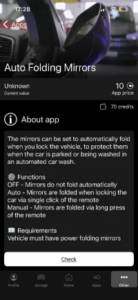

I tried again today, and spoiler: I did manage to make the OBD11 "Auto Folding Mirrors" App work. Here is how I did it:
- I turned the ignition on (but not the engine)
- I ran a full backup -> no particular reason why I decided to do it but I thought that if I try things I might as well back up all the data so I can restore it if needed
- I opened the bonnet/hood -> some people say that this is necessary to modify the data
- I went into Apps->Auto Folding Mirrors and I turned the setting to "Auto" and clicked on the tick to write the data (you have to click and hold for some...
