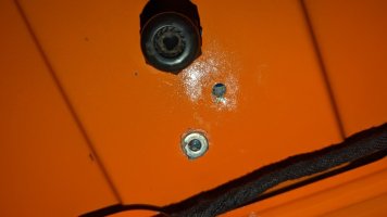

With it being an ex RAC van there are several holes in the roof, presumably from where lights and similar were mounted on the roof. What is the best way to seal or cap these off? Currently there is just some clear silicone in the holes which I'm not sure is a permanent fix.
These are the best I can get at the moment with a 5p for comparison. A few of them still have some of the original fittings in filled with silicone. Also apologies for the dirty first photo, it needs a clean!
The 20mm black stuffing glands can be removed and a 20mm PVC blind grommet put in its place each time, obviously a bit of propriety sealant applied at the same time too as the grommets are only push fit.
You'll still have a hole through the roof and the PVC grommets won't take paint but will be a lot more flush so less likely to be spotted by really tall nitpickers!
If that's a 5p, then its probably a 16mm stuffing gland? either way, a suitably sized blind grommet will do the job. With the smaller holes, a stainless button head bolt of a the correct dia with a nut in the van would tidy it up nicely

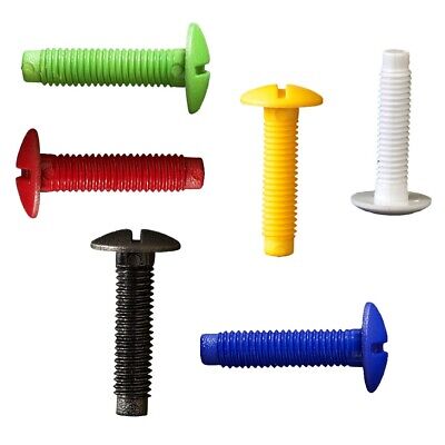

Maybe something like these with a bit of clear silicone sealant to add waterproofing until you can decide what to do next.
Or these..
You might even be able to find some Orange Nylon mushroom head bolts..
Remove all the bits going through the roof and use something like the above on the underside then a quick sand, fill and rattle can on top would be easy enough given its out of the way and a flat colour.
If using grommets I’d be inclined to use PU adhesive (bit like the stuff used to stick windows in with) as a bit more permanent than silicon.
Stainless bolts stuck in with the same stuff is another good idea. Flange head bolts have a bigger head size so will give more sealing area.

I just used 9.7 mm grommets for the two small holes and 19.05mm for the 5 bigger holes.

I used a stepper drill but for a neat hole. As pictures. B45A666E-22D0-4E72-A91A-B597776D0B1A.jpeg5D3124A9-0892-4D88-A571-6D8A7B73BF7F.jpegF7AB88D1-795E-4E4C-916F-F75445B463FF.jpeg

Hi, just wondering where you bought these grommets from. Just in the process of trying to fill exactly the same holes on mine.
I used silver foil tape (isolation) as temporary solutions until I decide what to do, not perfect but will do until i find better solutions
I'd be wary about using metal around that area as you'd set up a chemical reaction (electrolysis) which will end up with more chance of rust . I'd go for something like a lead sealant silicon with your rubber grommits. A bit more hardy than some other sealants. They are designed to be used on roofs anyway - but are very damned messy.
You'd want to clean it off while it is still gooey.
