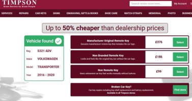

For a 6.1 I understand from Timpsons that they can do it - £186 if I put my reg online and well what is the worst that happens? You pay they don't deliver a working key and you get a refund!

My experience with my T6.1 was that Timpsons couldn't do it. A coded key was only available from a main dealer; it took about a month or so for the key to arrive from VW in Germany and the dealer needed the van at the workshop to code the key to the van. Not cheap but at least I now have a fully functional spare key. Never the less, l keep an Airtag on the key ring... just in case :eek:
