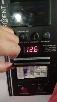

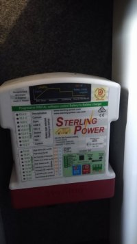

So, two pictures of the main unit that I associate with power to the van and what I assumed, maybe naively, were the fuses.
The white box was found when they said you should find a box to the right of the fridge behind the drivers seat for fuses - but that is enclosed (and I am not sure the person talking to me had it right - but who am I to say).

Okay, I think my single mains plug in the van is completely the domain of the RCD and three MCB switches. Based on this I don't think fuses are involved so the person I was talking might have been talking bollocks.
They are all on, which is the up position. If I move things down then I can tell I'm not getting outside power as the level goes to 12.x rather than 13.x. So, they are happy all in the up position and they don't trip.
If I push the test button the RCD switch drops down as it should and happily goes back up.
So I think that is all fine? Yet there is no power to the socket.
The white box near the fridge I don't think has anything to do the the hookup / mains and is instead the 12V routing and all the visible fuses are for that as well.
