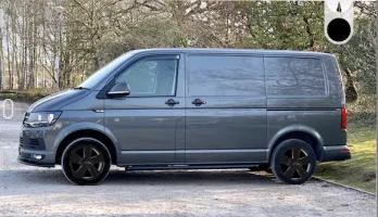

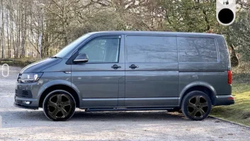

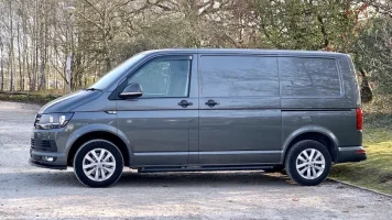

Just having a little play on the iPad (very rough mocks ups) to help decide on what wheels to get...
I'm thinking the A18" WOLFRACE EUROSPORT AD5 ALLOY WHEELS? Like the sport lines also in gloss black, but they come with polished lip, thinking that will get smashed up in now time!
What ya all think?

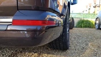

Either config would need spacers imo, if your wheels have a similar ET Off-set to a standard VW T6 wheel

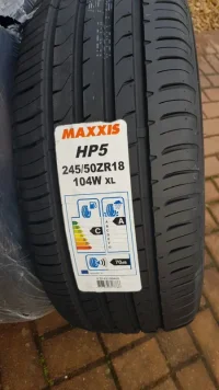

Just as an odd ball, I've just fitted these on 18 x 7.5J. Fractionally oversized (6mm) but if comfort is a priority, worth considering perhaps. I be very surprised if they lasted 35k but then they're half the money. I've seen a few magazine reviews but they seem to be a budget tyre that can hold there own with some of the premium brands. Certainly thoroughly impressed with the Maxxis Vansmart Snows that I use in winter. So will see how these fair...
Hey Chris thanks again! ET of wheels is 42 so they would stick out 28.1mm further than the stock 205/65/16. I’m guessing the spacers are for just that? Still learning…

I will do @LT2019 . Just need a little more time with them to give them a fair assessment in combination with the new wheel size. (Compare fuel consumption, wet/damp conditions on the twisties, fully loaded and so on). But so far my thoughts on them are favouable, and looking as though the pro's may out weigh the con's. I think Maxxis as a brand are better known for car/van/truck tyres in North America and Asia than they are here. But yes, well known in the cycling world.

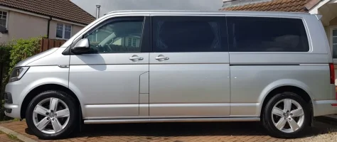

They look very nice! What rim are those? Where did u get it from?
These are VW Manaus wheels. They were an option on the Amarok pick up. Sourced second hand from a T6F member. Try a wanted ad on this forum, ebay, Gumtree or put a post on one of the FB Amarok forums for them.
