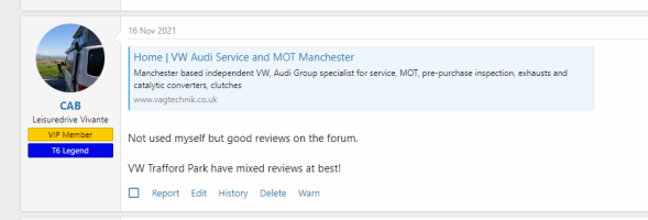

Thanks for all the replies. For my own sanity ill get the van back monday and find someone to take the head off and have a proper look.
Someone new I think , not that iv used before.
@Dellmassive can you find that thread from a few months ago where the guy had his engine rebuilt by a specialist in Halifax. I’ve looked and can’t find it. I’m sure it was a similar scenario from VW
