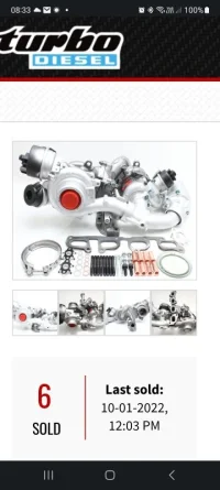

The 204 uses the bi turbo unit. Which is bought as a combined unit (small/large as one)
But they are separate turbos in there own right in regards to have sperate turbo spindles, so having one seazed is possible.
You can see pics below.
