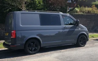

It’s taken a while, but managed to get the new Cantara’s on today.
It’s been a struggle - which is an understatement to be honest. It would appear that the last time the sportlines has new tyres fitted, the wheel bolts were over tightened, it has been hell of a job getting them off. Made worse by one that refused to come off - and that one was a locking bolt. Locking adapter/ locating face on bolt totally knackered. Had to result to drilling it off. After about 20 broken drill bits, a pretty well split knuckle, and 5 hours of swearing; we got there.
Brand new bolts and a touch of copper slip on each of them.
View attachment 60661 View attachment 60662 View attachment 60663
what size tyres and alloys are you running? This is the look i'm after, looks great
They'll be 255/45/19.... and if you want the 17" spare the same rolling radius that one would need to be 215/65/17
