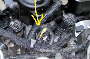

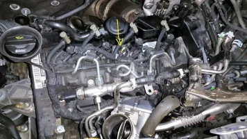

Before (possibly) taking cambelt off perhaps you could try do the same recording when camshaft sensor (G40) is disconnected (inspired by this thread here)
I'd like to propose the following:
VCDS Preparations​
  1. Ignition ON
  2. Do full VCDS-Auto-Scan: VCDS > Auto-Scan > Start (on T6 VCDS detects all modules automatically, no need to select chassis) > Save
  3. Read engine faults codes: VCDS > Select > Engine > Fault Codes > Save Codes > Clear Codes > Save Codes
  4. Ignition OFF
Disconnect the camshaft position sensor (G40) connector​

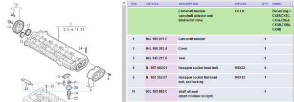

It's located between injectors 2 and 3. According to repair manual should be enough just to loosen charge air cooler on top of camshaft module. Anyways, shouldn't take too long even if some more disassembly is required - the picture below was taken after 20 minutes of tear-down - although not by me :whistle:
Please find T6 CXGB engine repair manual >here<
For disconnecting the sensor G40 - pages 384, then 389, etc.

Nice, if i disconnect camshaft sensor, engine will start so i quess camshaft module needs to be replaced.
  • Wow
Did you do any of the proposed VCDS data logging (above)?
