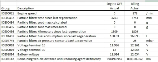

How does coincide ECU reporting last DPF regeneration being 1120 miles (1809 km) ago? Remap?
I haven't checked the DPF stats for a couple of months but it was regenning as expected.
Hmmm... how do you know it has been regenning?
Also the voltage readings are somewhat low - though was captured only 9 seconds after startup. Thus a longer recording of blockmaps would be more than useful.
Also quite a range before running out of AdBlue :speechless:
Please check exhaust tailpipe - is it sooty?
Very interesting........The remap and adblue/EGR delete were done 1131 miles ago, so its regenned 10 miles after and never again!

I would think the actual soot level is going to be high after approx’ 1100 miles without a re-gen.
What the ECU reads maybe completely different if the DPF was ‘deleted’.
it's saved me a blocked DPF
Well, hopefully - the pressure across the DPF is currently fairly high for a new DPF - suggesting the DPF regens indeed have been suspended. Would have expected to see well below 10 mbar at those conditions.
What did you spot with the voltages?
Oh sorry - the keyword was left out.
Also the voltage readings are somewhat - though was captured only 9 seconds after startup.
Voltage readings are somewhat weird. Just barely 12 Volts engine running - would expect to see more than 13.5 Volts fairly soon as engine has started. So hopefully the alternator just wasn't ramped up yet.
Yeh, definitely not been regenning - typically want 5-10mb at idle and under 50 at driving speeds......mines logging into the 250-300mb so it's done well not to complain but wasn't far away from a limp mode and glowplug light I think.

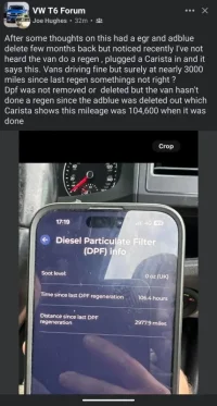

Coincidence is a funny thing - just popped up on FB:
I'm pretty sure Darkside always warn of removing an EGR on these where the DPF is still present.
Never really saw the issue, to my mind the EGR is fully closed during a regen so why would it matter that it's commanded shut all the time but this is familiar.
They have always said that but is it because they have a batch of replacement straight through exhausts to shift?
CFCA owner here running a blanked EGR with an emulator, no issues for tens of thousands of miles like many others.
Yup, makes no sense to me and I see nothing principally different with a potential link between EGR and DPF on this engine vs any other but Ill reserve a full statement for now ;)
