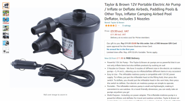

A high flow low pressure pump to inflate main thing to around 1psi.
Then swap to a high pressure low volume pump to raise the pressure from 1psi to 7psi.
my main pump for a few years has been the trusty Kamper Gale.
but it did take ages to do the initial fill . . . . so . .
i ended up getting a cheap hi flow pump, to get the beams up . . . to then move over to the Gale. ( so basically had two pumps)

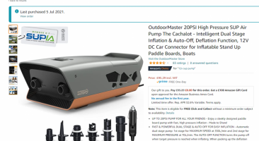

till this year, !!!! where we upgrades to this two stage twin pump designed for SUPs.
This thing is Awesome . . .
it has two separate pumps inside, when you start it up the first pump does the quick fill to 1psi - at which point the second pump kicks in and raises the pressure to the 7psi setpoint.
its auto OFF as well.
just set the pressure 1-20psi and that's it. ( i set at 7psi for all the air-beam tests etc.)
  • UP TO 20PSI PUMP FOR ALL YOUR FRIENDS - Enjoy a sleekly designed paddle board pump with fast, high pressure inflation - Made to Share!
  • FAST & POWERFUL DUAL STAGE & AUTO OFF FOR EASY INFLATION - Automatic dual stage pump: 1st stage for MAXIMUM SPEED at 350L/min and 2nd stage for MAXIMUM PRESSURE at 70L/min. The AUTO-OFF FUNCTION turns the pump off when target pressure is reached when inflating. When packing up the deflation function will MAKE DEFLATING QUICK & EASY.
  • 12V DC CAR CONNECTOR & FULL SET NOZZLES ATTACHMENTS - Connects to your car's 12V DC connector. Features a 12A fuse for increased safety. Comes with full set of nozzles to fit most high pressure inflatables including C7 & H3 valve.
  • DIGITAL DISPLAY WITH REAL TIME PRESSURE MONITORING - Use the digital display to set your desired pressure and monitor the pressure in real time. PUMPING HAS NEVER BEEN EASIER!
  • ECO-FRIENDLY & TEST-APPROVED - The Cachalot has gone through rigorous testing and has CP65 and CE certifications. Durable quality and eco-friendly material offer a promising summer journey.
so either get the two separate pumps.
or get the one twin SUP pump.

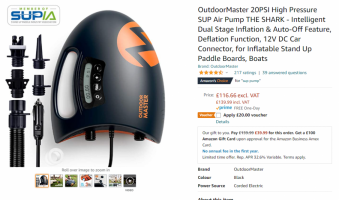

they also do another version called the shark.
About this item​
  • ACTIVE COOLING SYSTEM - The one and only SUP electric air pump with active cooling system up to 20PSI FOR 3 BOARDS IN A ROW - Enjoy a sleekly designed paddle board pump with fast, high pressure inflation and consistent cooling system - Made to Share!
  • ECO-FRIENDLY & TEST-APPROVED - The SHARK has gone through rigorous testing and has CA65 and CE certifications. Durable quality and eco-friendly material offer a promising summer journey.

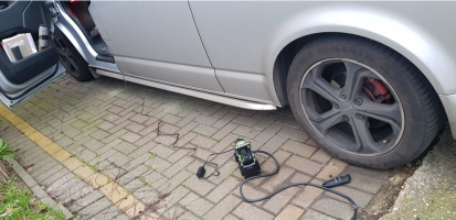

also none of these pumps are any good for a van tyre at 50psi or so . .
for that you need a twin piston 12v pump.
have a look here for one of those . .
