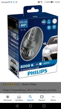

The headlights you have are similar to the ones I suggested. These are the bulbs that came with mine. The do give a bulb out warning, but that can be coded out.
