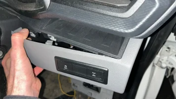

Does anyone have info on the 6.1 lower dash drivers side . I’m stuck on the panel with the headlight controller. That’s the easy bit I have unlocked the switch and got the screw out . I’m terrified to damage anything .
If its the same as the T6, take the side panel off (revealed when you open the drivers door see post #3, post #48 may help as well on the 6.1), take the panel that is above the pedals off and you should be able to look inside with a torch and a mirror to see where the fasteners are.
I've had that panel off and don't remember anything difficult about it apart from the lightswitch, there may be a screw in the hole where the switch goes if I remember correctly.
Thanks @Grim Reaper I will try taking the flat panel at the bottom first . The passenger side & glove box was so easy I was wandering why it wouldn’t budge . I already have the side bits and the light switch out .

The clips are quite meaty all the way round that panel. The screw in the light switch had me fooled for a while! Then it is mainly brute force.
