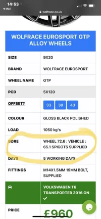

Standard cb is 65.1 for t6 iirc, not sure what cb the wolfrace wheels are, should be a common size though as loads run them.
