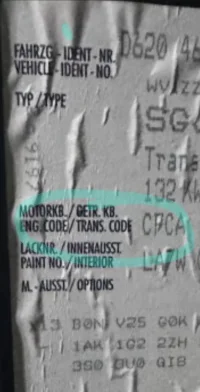

You need to get the engine code to be sure...Ahh ok so the Eu5 we have should be clear of it hopefully?
Brilliant thank you for your help I’m gonna get an oil test done too and start doing them regularly to help keep on top of everythingThat looks like, eng code CFCA to me.
And you have a rev D EGR cooler.
So you should be good. You have a later revision.

you have a CFCA engine.Could not see the sticker under the dashboard, where under the dash?? but have the data card in the service book
kc
see here:you have a CFCA engine.
and a REV-A cooler.

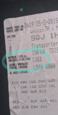

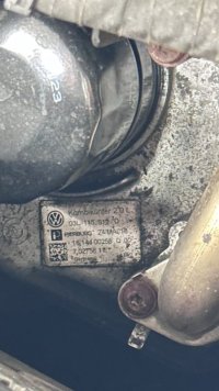

You have a CXEB engine...Evening guys and girls
I’ve been reading thro all the different posts regarding the numerous issues with the 204 bitdi and decided to dig thro the paperwork I received as well as checking for the sticker under the dash. I’ll attach the pic of the sticker as well as a service/repair report I’ve come across. Please could someone (far more knowledgable than me) has a look and see if I should have any concerns? The van does seem to be using more coolant than I’m comfortable with. ie filling the coolant every 1000 miles. I’ve checked the oil usage (warm engine) and that doesn’t seem to have changed at all
