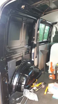

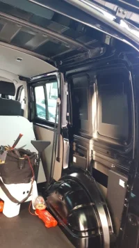

Had a spare and a dry day so i was able to pop off the panels and roof in the rear ready to insulate. Also put some wires in for some cargo lights below the bed and some into the tailgate with a fishwire for the future. Bit of PITA to get round the rubber but thanks to the forum, I was able to sort it.
Q-Do the exsisting sticky panels need removing before fitting the dodo panel pads????
